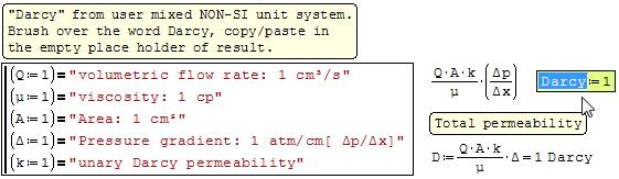

mD is an absurdly small unit which I defined as:
where 295 is
which I hope is alright.
if I make a statement, like
k:=20'mD
"and then query k,
I get results that seem to round to 1 decimal place, ie
2*10^-14 m^2
ohh my goodness that is ~1.5%, which is poor performance compared to all the other awesome features!!
it seems to do this in decimal mode, and not in fraction mode, which sort of makes sense, that the fractions would not be rounded the same way.
Seems like a wierd floating point error.
also the behavior isn't always reproducible. very strange.
thanks for the awesome program!

... many more Engineering don't come as easily as 2*3=6 m²
You don't have to freak Smath unit system, just like this:
... rather like this
