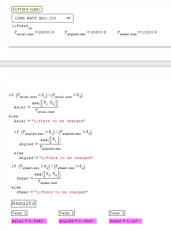

I am new in sMath topic. Can anybody tell me why here my combobox doesn't work correctly? It doesn't download values from rows.
Thanks!

I have identified two errors:
1) you must assign a variable to the combobox
2) seems to have disabled the evaluation of the combobox
[albumimg]1508[/albumimg]

#11 Posted: 8/21/2018 10:07:52 AM
115 likes in 329 posts.
this
Lifterscheck.sm (21 KiB) downloaded 84 time(s).
