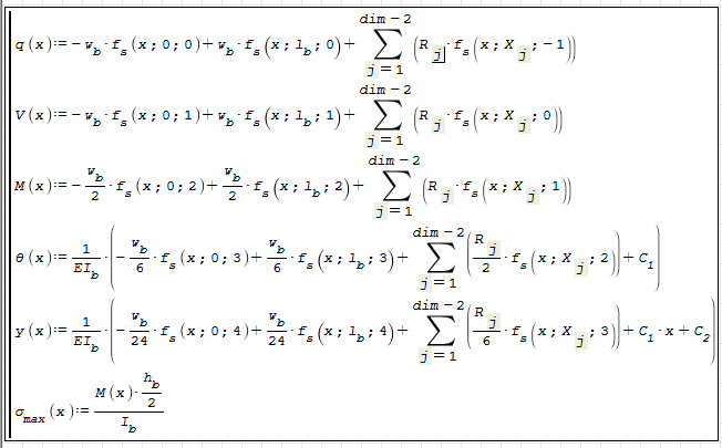

Dear all,
Some years ago, I worked out a beam calculation tool in smath, based on singularity functions.
The sheet worked flawless in an older SMath version, but the most recent SMath-incarnations result in problems: the error seems to originate with the summation command.
How do I get this program working again?
I attach the original files: thanks for any feedback!
Kind regards from a Belgian SMath-fan,
Jan
Original file with summation error.sm (143 KiB) downloaded 93 time(s).
Original file working.pdf (190 KiB) downloaded 109 time(s).

Hello.
This is because of using "i" as a variable. Currently we have some issues regarding it. Will be addressed soon.
Simple change to fix your worksheet:

Hello.
Alternately: define the summations as local variable [SS 6179]

Thank you Andrei & Jean for the fast feedback!
