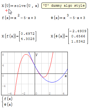

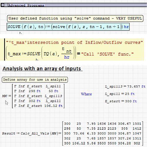

SMath Forum SMath Studio Samples Solve Algo Style 1 Pages (3 items) Solve Algo Style - Solve Algo Style - Messages Go to last post #1 Posted: 7/9/2018 11:00:05 AM Jean Giraud 983 likes in 6866 posts. Group: User Useful for collecting multiple sets of solutions.JeanSolve Algo Style.sm (4 KiB) downloaded 86 time(s). #2 Posted: 7/9/2018 12:43:13 PM NDTM Amarasekera 130 likes in 352 posts. Group: User WroteUseful for collecting multiple sets of solutions.JeanA similar approach used in the attached example.Small Dams Flood Routing Ex-Program Method-Original-Simple3-R4.sm (1 MiB) downloaded 89 time(s). Look within!... The secret is inside you. Best Regards Eng. NDTM Amarasekera - Sri Lanka #3 Posted: 7/10/2018 10:35:34 AM Jean Giraud 983 likes in 6866 posts. Group: User WroteA similar approach used in the attached example.Thanks Collab, great projectPage2 NDTMA.sm (88 KiB) downloaded 79 time(s). 1 Pages (3 items) New Posts No New Posts
