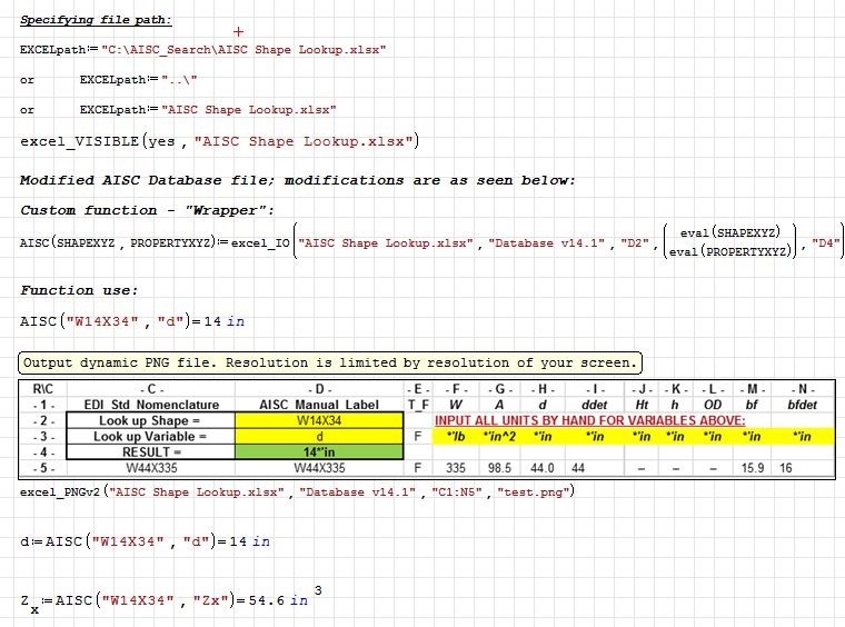

Not sure if I am grasping the root of the issue, but you can fairly easily write a wrapper as a smath user defined function using excel_IO. One would think that this way you can write a wrapper for any custom .dll for EXCEL.
All I have done was creating a simple Index(Array,Match(),Match()) lookup in EXCEL (with proper implementation of SMath units), and used excel_IO to work with it.
Seems to work very fast.
As always - please test for bugs and use at your own risk.
P.S.: Update excel plugin for proper handling of cell error values
AISC Shape Lookup.xlsx (3.27 MiB) downloaded 1762 time(s).
Steel Properties Look-up.sm (20.36 KiB) downloaded 1257 time(s).

ioan, i am working on getting the files downloaded and figured out. but reading the comments, i think that the root of the issue is getting missed.
the database and spreadsheet by design is supposed to have blank vertical regions because not all shapes have all the same properties. we don't want to process it further. we really done want to decompose it and condense it. that will lead to errors and confusion.
the database and spreadsheet get regularly updated. this file in fact has been in use for 15+ years. when updates to shapes occur, these files get republished. that way, there is some predictability in accuracy in information, and repeatably.
ryan- look again at the example that Alex.M put up. I think I emailed you another example sheet when i got it figured out. all you do is program the shape and property you are looking for and it talks to excel and it spits it back to you. you don't have to worry about lookups and column numbers.
it pains me to say so, but i think that you are doing way more work than is needed in your example calc. and there is the issue of verification. by burying the calcs in hidden sections and then recalling it is hard to check and verify. are you really saving much time doing this sort of calc in SMath vs something like RAM Sbeam? for one beam design, its hard to beat.
here are some examples of how the calcs are done in excel. first picture has 2 halves. left half is what i print. right half if i need to put it in the calcs as a reminder or for review/permit. individual cells in gray on the left are user input.
the second picture, the stuff in gray is what is behind the image of the connection on the right side, and is some of the work in the background. and yes, i am little guilty of doing the same thing i pointed out to ryan as bad form, but the calc topic and result is more explicit.
I think the best solution right now is what Alex provided us so far- giving us a pseudo-wrapper to push/pull from excel. we can simply define the shape and the property we need and move on with our calcs.

First of all I would not want to take credit for something I have not done - it was RFeund who created the majority of the SMath workbook you were looking at. I just helped him to make it work as he intended. So I will leave it up to him to incorporate first of your two very relevant comments.
Small note though - the latest version of the plugin (0.2.0.28218) should import values with units from excel. Those units can be converted to inches as per usual SMath operation:
I will want to learn how to use combobox plugin - I beleive the worksheet you attached earlier is a good guide :-)
