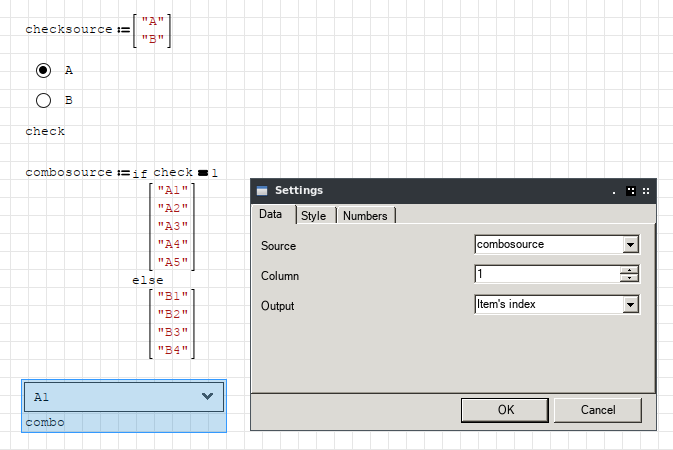

Hello, Davide. I was curious if there was any way to set the ComboBoxList source programmatically rather than through the Settings dialog. What I'd like to do - if it's possible - is to be able to use an if statement to control the source and populate the dropdown options for this combobox based on which radio button was picked by a user earlier in the worksheet. I don't know if that's even possible now, but it might be a nice feature to add someday if it's not :d
Something like
If option 1 then
Combobox1.source = matrix x
Else
Combobox1.source = matrix y
There's probably some issues there with needing to define the source first for the box to be usable, but the properties not being defined prior to the combobox's location in the worksheet, or something along those lines. But I thought I'd mention it. Also, sometimes, the dropdown list is transparent and equations/text below the combobox show through it and make it hard to read. It doesn't do that all the time, though, so I'm not sure on a possible cause, but I thought it'd be worth mentioning as well.

It is possible already, maybe not the way you mentioned but it gets the job done.
combolist.sm (4,47 КиБ) скачан 1913 раз(а).

Very nice! That worked just fine. Thank you!

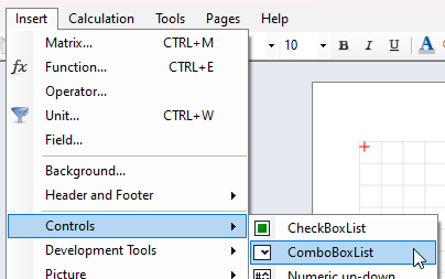

#38 Опубликовано: 30.06.2023 05:47:49
once you installed the plugin (from tools > plugins... > switch "Local storage" to "Online Gallery" > search combobox) you'll find the region in the Insert > Controls menu.
Thanks. I didn't have that option, but a restart of the program fixed it.
