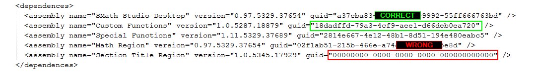

#44 Опубликовано: 20.08.2014 05:14:54
Seems that the file was saved using an old version of the plugin; meanwhile standards for plugins design was well defined, so a unique identifier (guid) was introduced for each plugin. It is easy to fix and you can do it by yourself.
Please open your worksheet with a text editor (Windows' Notepad, Notepad++, etc...)
Look at the headers of the XML code; you should see a block of code like this
<dependences>
      <assembly name="SMath Studio Desktop" version="..." guid="a37cba83-b69c-4c71-9992-55ff666763bd" />
      <assembly name="..." ... />
    </dependences>
Also, you should see that the plugin has saved a null Guid
<assembly name="Custom Functions" version="..." guid="00000000-0000-0000-0000-000000000000" />
To solve the issue, replace the null guid of Custom Functions with the official guid
18dadffd-79a3-4cf9-aee1-d66deb0ea720
Let me know if this solve your issues

#45 Опубликовано: 20.08.2014 05:35:50
Jure
Jure
Thanks for super fast replay! It works now! thanks again!

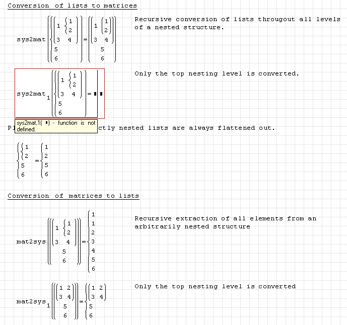

#51 Опубликовано: 22.09.2015 04:02:09
sys2mat.1() again seems to be missing...
sys2mat.1.sm (4,89 КиБ) скачан 1641 раз(а).

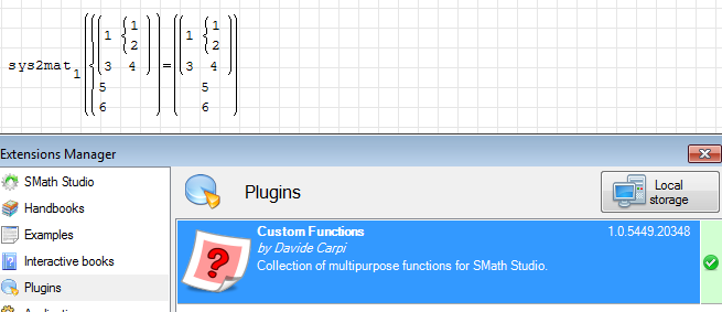

#52 Опубликовано: 22.09.2015 05:11:36
works for me... what version of the plugin do you have?
#53 Опубликовано: 22.09.2015 05:51:39
seems to be up to date.
EDIT: The function is avaiable, but obviously there have been changes in handling text indices. I choose sys2mat.1() from the dynamic assistant but the .1 won't display as text index. Once I delete the dot and type it in again, then the text index appears and the function becomes undefined.

#54 Опубликовано: 22.09.2015 06:08:52
Found the bug, I'll update the plugin ASAP
Radovan Omorjan 22.09.2015 07:15:00
#55 Опубликовано: 22.09.2015 06:40:10
PLUGIN UPDATED
- fixed localization issues in sys2mat.1() (thanks to Martin Kraska)

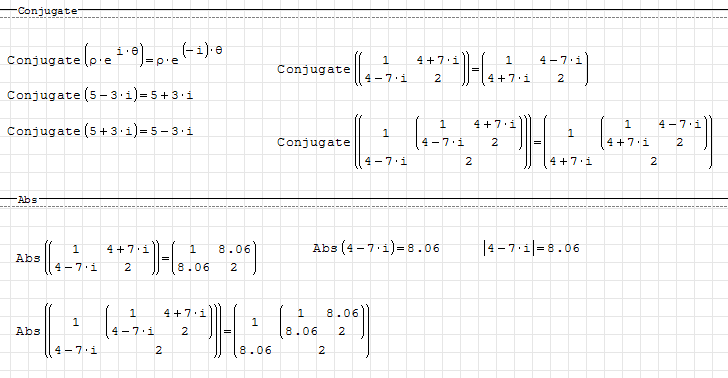

#56 Опубликовано: 16.01.2016 12:40:38
PLUGIN UPDATED SMath Studio 0.97.5346 and later and SMath Studio 0.97.5737
  • added Abs(1) (extends built-in abs(1) to matrices);
  • added Conjugate(1);
  • improved description of InterpBilinear(5);
  • refactoring;
2016-01-16 16_42_21-SMath Studio Desktop - [CustomFunctions_examples.sm].png
ioan92 16.01.2016 12:49:00, sergio 16.01.2016 14:24:00
#57 Опубликовано: 19.01.2016 12:51:21
Thank you Ioan, bug confirmed. I'll fix it ASAP.
ioan92 19.01.2016 14:42:00
