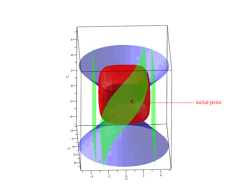

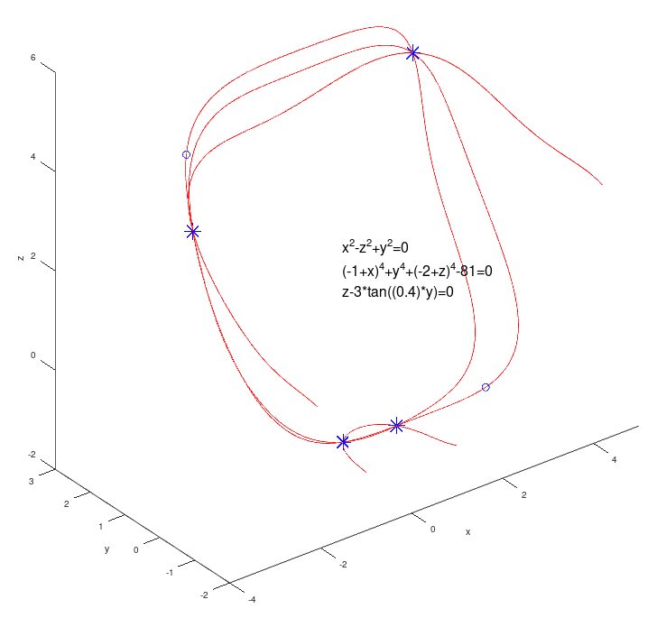

x1^2+x2^2-x3^2=0;
(x1-1)^4+x2^4+(x3-2)^4-81=0;
x3 - 3*tan(0.4*x2)=0;
Solutions to check out:
0.591395 -0.801312 -0.995916
-0.555082 -0.759905 -0.941049
-1.898741 1.789592 2.609187
3.362054 2.347994 4.100791
Some initial points:
2.598017 -0.736709 -0.953833
-1.826666 2.073210 4.007231
1.106031 -2.246909 -0.936232
In the figure, the solutions are shown with an asterisk, the red curves are obtained when different initial conditions are given.

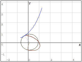

On how to obtain equations of circles inscribed between smooth curves. The Draghilev method is used.
Topic on the MaplePrimes forum.

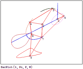

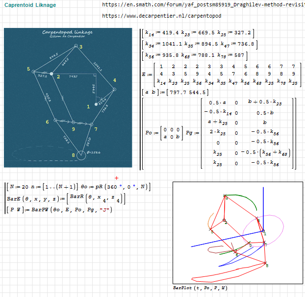

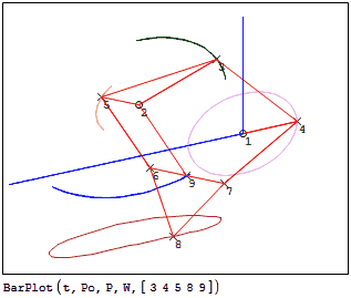

Интересная задача. Как спроектировать стол на шагающих ножках, чтобы поверхность стола оставалась горизонтальной.
Click to enlarge Click to enlarge
Links:
1.Carpentopod: A walking table project
#153 Опубликовано: 12.10.2024 22:57:33

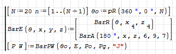

Hi Viacheslav. You can try here the linkage bars system in general, and the Jansen's linkage in particular:
This is an approach to the carpentopod linkage, taking two fixed points. I guess that maybe it must have only one fixed point, BTW, it seems to move the table, although things on the table will probably fall off if the coefficient of friction is not high enough. So, take this just as a case study.
LinkageBars-carpentopod.pdf (601,18 КиБ) скачан 1040 раз(а).
LinkageBars-carpentopod.sm (704,52 КиБ) скачан 1687 раз(а).
#154 Опубликовано: 13.10.2024 05:13:52
Adding the condition that points 6,9,7 are collinear, we have a stable solution.
In SMath:
Inscribed Circles - Dragilev Method.sm (22,91 КиБ) скачан 1626 раз(а).
Inscribed Circles - Dragilev Method.pdf (89,12 КиБ) скачан 931 раз(а).

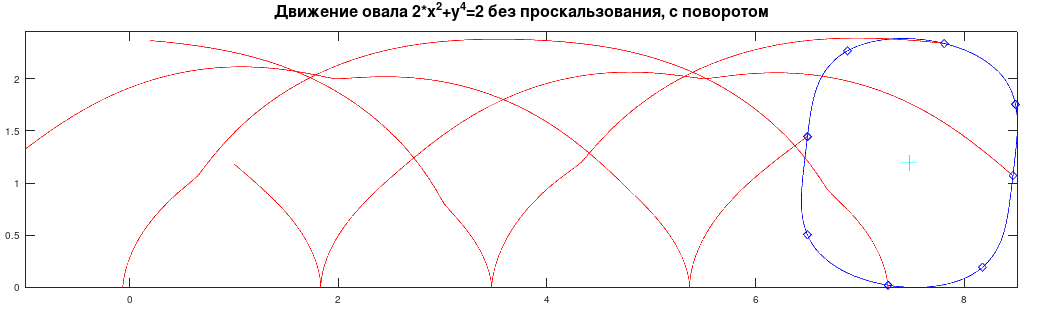

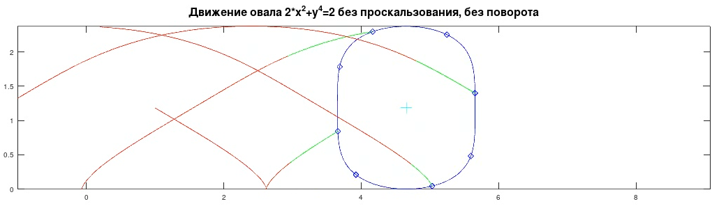

[RUS]Движение овала без поворота и без проскальзывания[/RUS]
[ENG]Movement of the oval without turning and without slipping[/ENG]
olv.mov (419,61 КиБ) скачан 395 раз(а).
[RUS]Движение овала с поворотом и без проскальзывания[/RUS]
[ENG]Movement of the oval with turning and without slipping[/ENG]
olv1.mov (519,66 КиБ) скачан 402 раз(а).
[RUS]Точки фигуры получаем хотя бы методом Драгилева. Меняем правую часть, чтобы складывалось движение по кривой и движение центра в случае, когда поворота нет. Когда поворот двигаем центра и вращаем точки по окружностям. Незабываем в этом случае вычесть минимальное значение, чтобы овал "катился".[/RUS]
[ENG]The points of the figure are obtained at least by Draghilev's method. We change the right part to add up the movement along the curve and the movement of the center when there is no rotation. When there is a rotation, we move the center and rotate the points on the circles. Remember to subtract the minimum value in this case, so that the oval “rolls”.[/ENG]
Alvaro 30.10.2024 00:11:00

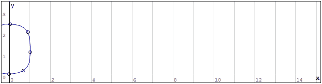

... [RUS]Движение овала с поворотом и без проскальзывания[/RUS]
[ENG]Movement of the oval with turning and without slipping[/ENG] ...

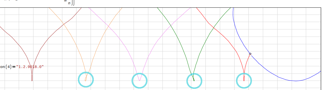

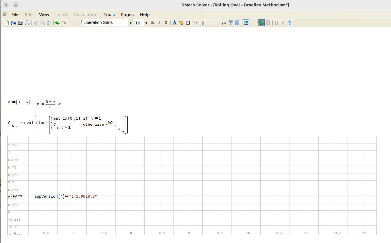

This case, in SMath.
Rolling Oval - Dragilev Method.sm (14,59 КиБ) скачан 1729 раз(а).
#160 Опубликовано: 30.10.2024 22:09:28
grelkin2
grelkin2
14 сообщений из 67 понравились пользователям.
Very good, but there are some minor drawbacks. In linux smath does not work very well. I have all calculations going on the right side of de system. I calculate the coordinates of the tangent point and respectively the rotation speed of the oval. At the tangent point the velocity is zero and a tick icon is observed.
