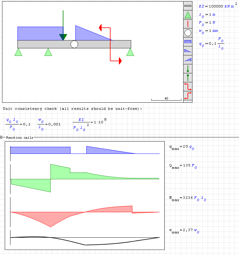

BeamFEA updated:
Unit support was non-trivial. I failed to make the solver unit-proof because matrix inversion with units is not robust in SMath (probably due to poor pivot scaling in the algorithm).
Also, you easily can create programs which will crash SMath immediately after opening them (if auto-recalculate is on). I added this to SS-1227.
- unit support. You can specify units as factors for the modeler units. The preprocessor eliminates the units such that the solver input is unit-free. In the output the appropriate units are applied and can be modified as usual for display. Note that you can define separate units for length ('l.0)and displacement ('w.0).
- separate diagrams for distributed load, transverse force, bending moment and displacement
- input color scheme changed:
- concentrated moment load and rotational constraint in red
- concentrated forces and vertical supports in green

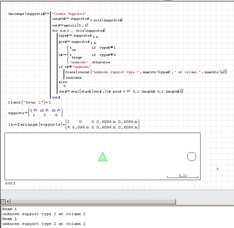

RFreund, sorry for not being responsive lately. Quite busy at the moment.
I think for the supports you succeeded to implement the translation function from your favorite input format to modeler output. I just made some modifications:
- better readibility by introduction of temporary variables and by replacing nested ifs by cases()
- better robustness by creating valid modeler input even in case of unknown support type. In that case, a detailed error message is written to the output window via trace(). This is essential, as the input selection in the modeler gets lost whenever the input renders invalid. This is annoying, because you have to re-select the pre-defined layout in the modeler again.
Excellent Martin. Thank you. I will post back soon, hopefully, with loading, etc.
