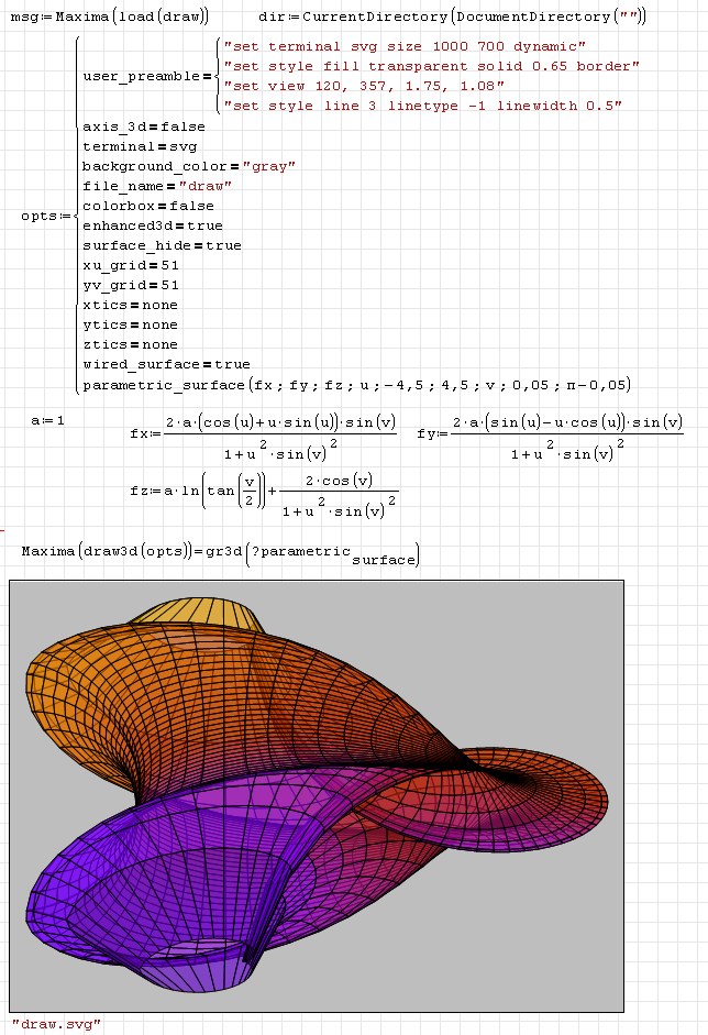

#26 Опубликовано: 28.12.2013 02:42:48
Resizing the images works for images created with the standard gnuplot interface of Maxima, images generated with the draw package still cannot be scaled (did not yet find the right settings).
Ah yes, you are right. Did not pay attention, sorry.
Here are some examples with draw package
Martin Kraska 02.01.2014 22:27:00
#27 Опубликовано: 02.01.2014 22:28:44
from the gnuplot examples page
#28 Опубликовано: 02.01.2014 22:30:29
From the gnuplot examples page
EDIT: file corrected
Example Maxima Gnuplot transparent solids.sm (10,42 КиБ) скачан 1357 раз(а).
Radovan Omorjan 03.01.2014 02:43:00, Вячеслав Мезенцев 03.01.2014 12:31:00

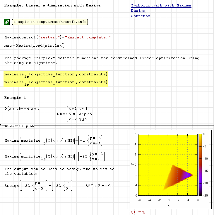

Example for linear programming and plotting
Radovan Omorjan 03.01.2014 11:59:00

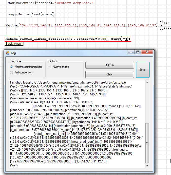

#33 Опубликовано: 03.01.2014 12:21:30
This was nice as well, thank you
By the way, I tried most of the stats hypothesis testing functions and they work by following your example how to do that. One of them did not work regarding simple linear regression. Here are the test file and the log file as well. From the debug window I had the impression that the calculations performed well, but there is no SMath output (again "stack empty" error).
Martin Kraska 03.01.2014 13:10:00
#34 Опубликовано: 03.01.2014 13:04:28
There seems to be a problem with display of functions with list arguments. In the given case, you can avoid the function in the output by wrapping it in args(), which returns a list of the function arguments.
The outer mat2sys is just for cosmetic reason. I just prefer that type of results being left justified.
Make sure to set optimization None in the function call and in results display to get float results. Opt numeric won't work due to the texts being bare variable names.
It seems that the functions are capable of handling matrices.

#35 Опубликовано: 03.01.2014 13:57:02
Unfortunately, it does not work for me.
I can not use matrices here, therefore I defined it in Maxima with Maxima( "$ $" ). If I use a matrix like you did with matrix M, the error message in the debug window appeared
apply: second argument must be a list; found: M
#0: simple_linear_regression(dat=M,select=[conflevel = 0.99])
-- an error. To debug this try: debugmode(true);
(%i7) "
Moreover, when I use the same command as you did, no result - stack empty again, although still look that the result is here - see the log file please.
Maxima.zip (1,19 КиБ) скачан 423 раз(а).
#36 Опубликовано: 03.01.2014 16:13:36
The problems seem to be arg/dec separator related. I can reproduce a crash with my file. It occures in the back-translation step. This is definitely a bug with little chance of fast fixing (Kay has to focus on exam session).
What puzzles me is that the error message refers to the second argument. In the call, M is (should be) the first argument.
If you still want to go on testing, then as a workaround you might extract individual elements of the solution. Could you please try that? If that works, then the matrices should not be an issue. Could, however, be a Maxima version issue (newer versions might be more picky about argument type than mine). I still use 5.31.1-1.

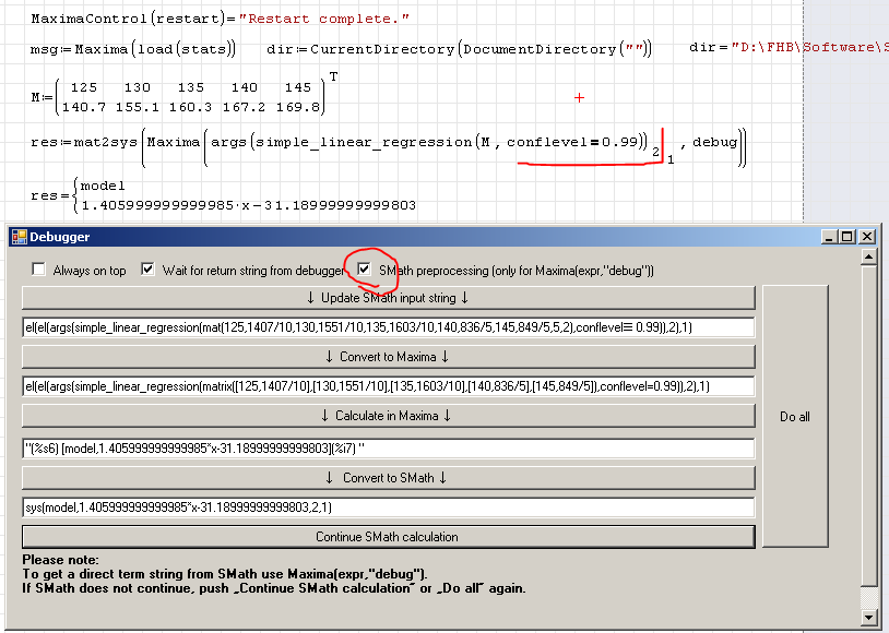

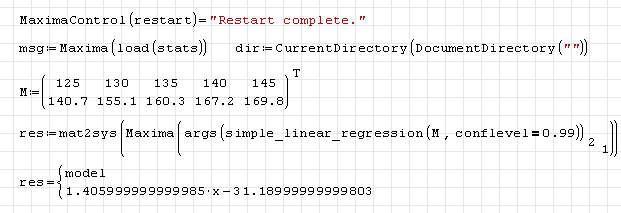

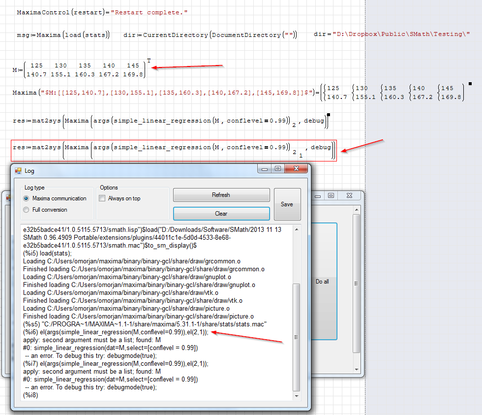

#37 Опубликовано: 03.01.2014 17:42:58
I use the same Maxima version as you do 5.31.1-1. I am really puzzled that whatever works for you in this example, it does not work for me. I just tried and again here are the two pictures with matrices M defined in two ways and their respective logs - with errors. I also noted that matrix M is referred as second argument? Have no idea what that might be. I alo tried to change the arg/dec into coma and semicolon - no sucess.
If there is anything else I could try regarding this - just let me know. Otherwise, we can just wait for Kay
#38 Опубликовано: 03.01.2014 19:00:21
I think there are two problems:
1. If in the debugger, you have to set the preprocessing flag. Otherwise M is not replaced by it's symbolic contents. The dialog is obscured by the log but I would bet a pivo that you did not set the flag ;-)
2. You applied the second el() function to the index 2, not to the complete expression. You want the first list from the result structure. I admit, that this was not obvious from the screenshot.
Removing the debug flag from the Maxima call and correcting the el function should do the job.

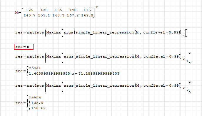

#40 Опубликовано: 04.01.2014 04:34:50
You definetelly won a pivo (more than one actually ).
You are right again, my mistake sorry. Here is the screenshot. If I understood you well, the complete calling of the entire system here is problematic - maybe a bug (sometimes it crashed for me as well) but it can be done by calling one by one - like in the picture.
