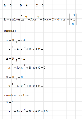

#30 Posted: 4/16/2015 11:44:55 AM
1,442 likes in 2,935 posts.
No issues here

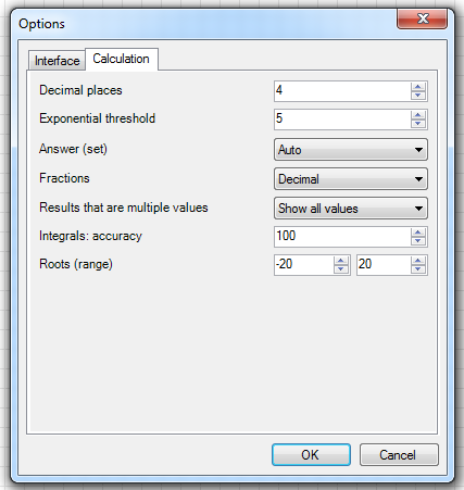

#32 Posted: 4/16/2015 6:20:16 PM
I see... BTW also the cloud version gives 3 roots
Yuo can try to check if something is different in the global settings (Tools > Options... > Calculation)

#33 Posted: 4/16/2015 8:09:42 PM
robinson
robinson
0 likes in 3 posts.
Now is working. I changed Roots (range).

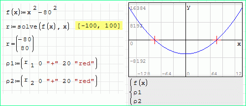

Here are your two plots c/w the roots shown on graph.
I have used the 'Solve Quick' in separate sheets not
to confuse solve[f(x),x] with the two differents
search range. Handling graphs are very easy, just a
matter of adjusting each direction [X,Y] separately.
Your solve with bracketed search range is perfect too !

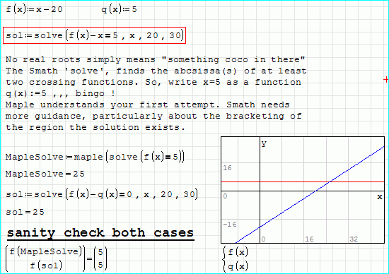

Your turmoil is solved. Always plot before you attempt more maths.
