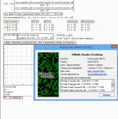

#23 Posted: 8/3/2016 7:40:10 PM
Hello Jean ,
It would be better to put the animation in a 3/4 view . Would that be possible?
Best Regard
Carlos

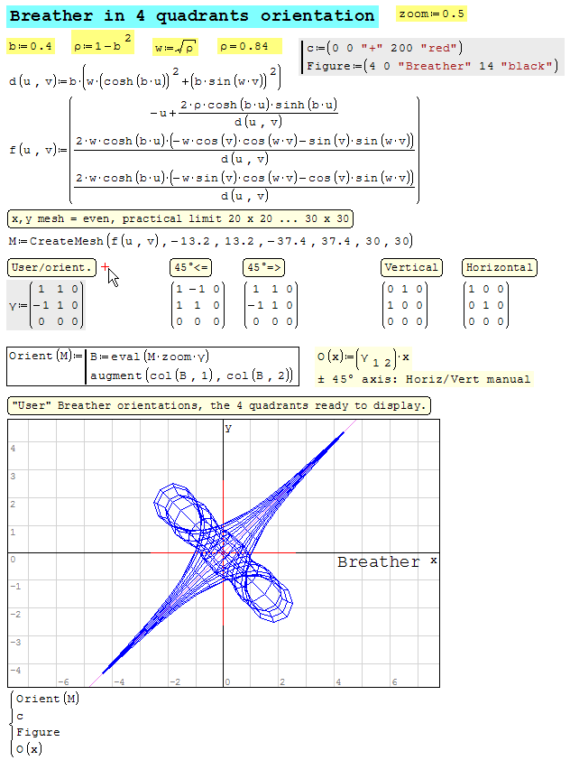

Hello Carlos,
"3/4 view" : like setting TV screen 3/4 or other style.
You could scale the vertical vector, it would end being
hugly. The x, y ranges in the CreateMesh have these limits
under the hood. These limits are what make the Breather
so pleasant like the Eiffel shape.
Attached the 4 fixed orientations.
Rotate Breather [4 Orientations].sm (17.15 KiB) downloaded 1457 time(s).
#24 Posted: 8/4/2016 1:19:20 PM
CBG
CBG
78 likes in 312 posts.
Hello Jean.
Excellent !!!
But the file does not work for me, it indicates that M is not defined.
Besides, I can not update the Maple plugin .
On the other hand , Is it possible to see a 3/4 view from the Z axis?, I think it will better.
Thank you.
Carlos

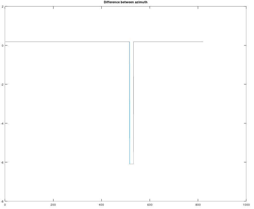

In my option this system have
  • Rigid link between 2 points
  • 2 equations about belonging 2 points to the same sphere
  • x2*y1-y2*x1
  • some sin curve
    Don't quite understand about x2*y1-y2*x1. Some spherical meaning? The difference between azimuth angles is not perfect equal. Replace with atan(y1/x1)-atan(y2/x2) to make perfect equal.

#30 Posted: 3/10/2022 4:07:49 PM
grelkin2
grelkin2
14 likes in 66 posts.
Hmm, atan is expensive function, may be switching to spherical coordinate reduces number of steps
initial vector
1.5355 0.8065 0.9959 1.9127 0.5761 0.0989
precision 1e-3
sphere(1,0,0,0)
sphere(2,0,0,0)
line(1,2)
atan(x[1]/x[0])-atan(x[4]/x[3])
.5*sin(8*x[3]+9*x[4])-x[5]

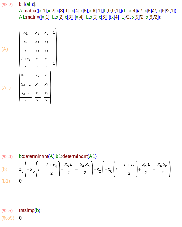

#31 Posted: 3/15/2022 1:33:50 AM
grelkin2
grelkin2
The Schatz mechanism
The Schatz mechanism provides a perfect dynamic balance
оf both centripetal and centrifugal forces as patented in 1971
as the only widely-used overconstrained linkages in industry,
mainly used as spatial mixing-machines.
It has equation four points are coplanar
Maxima gives me this equation is exactly is zero with any coordinate

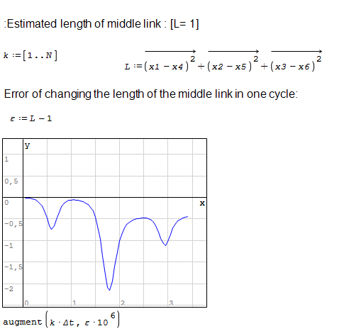

#34 Posted: 3/24/2022 5:12:58 PM
Fridel Selitsky
Fridel Selitsky
520 likes in 451 posts.
The error of changing the length of the middle link is ε = 10^{-7}
You can also check the perpendicularity of the hinges
Proverka.sm (47.9 KiB) downloaded 1639 time(s).

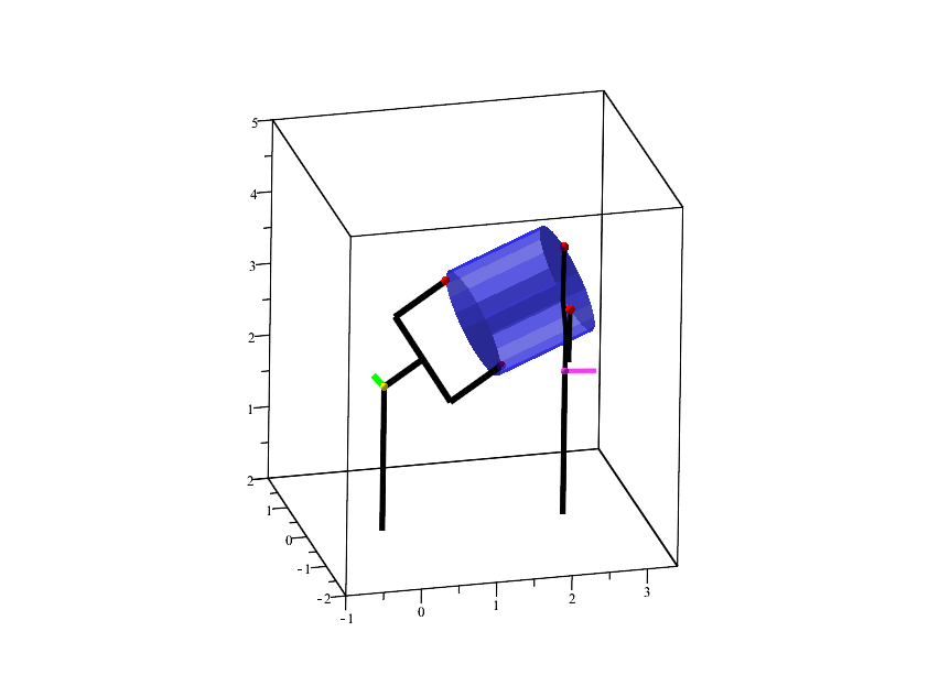

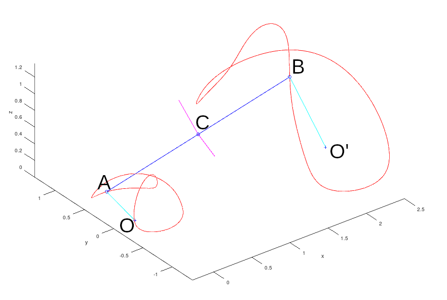

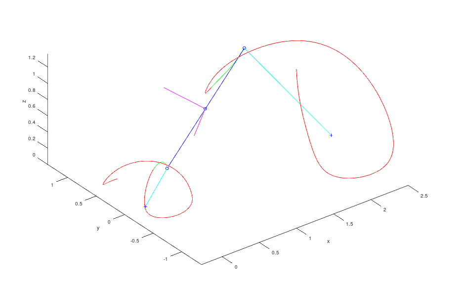

#35 Posted: 4/11/2022 8:33:46 PM
grelkin2
grelkin2

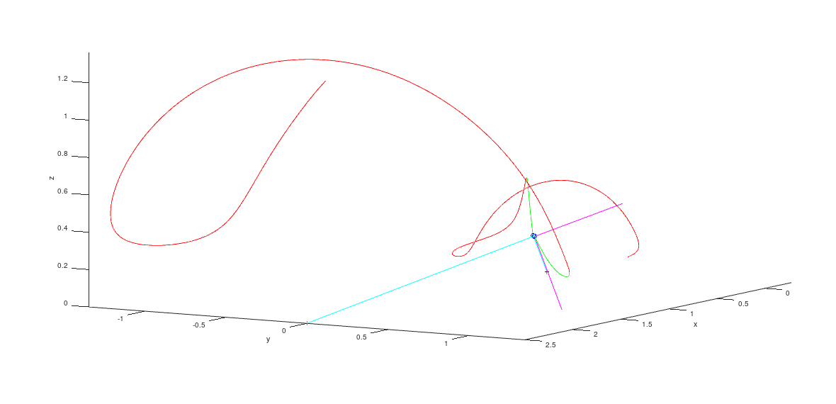

To @Ber7, @алексей_алексей
Not really understand Schatz system
Please correct me if I'm wrong
AO=const, BO'=const, AB=const
С extra point, AC=CB
Still two equation, one as I understand Z1*Z2=const?
and the last one is
Normals to planes ABO and ABO' must be perpendicular?
Magenta lines are normal vectors to ABO and ABO'
Pause and check perpendicularity
Rotate the view to get best observation
Make animation in mov format for the best quality, If not working, message me
Animation schatz.mov (285.1 KiB) downloaded 359 time(s).
#36 Posted: 4/13/2022 11:37:22 AM
Fridel Selitsky
Fridel Selitsky
Please, read the article at the link post # 27.The length of each link is equal to one, and the distance between the vertical axes is equal to the root of 3.Equation x3*x6 = 1/2 derived from Equation (6) of this paper.
"Normals to planes ABO and ABO' must be perpendicular?" Yes.
#37 Posted: 4/13/2022 2:39:49 PM
grelkin2
grelkin2
sinθ_2*sinθ_5=const
θ_2, θ_5 rotating angles around the ZA2, ZB2 rotating axis, difficult equation
You cann't use any intial values for coordinates because ABO and ABO' must be perpendicular, if you fixed all coordinates but one, you've got Quadratic equation. If you have no real roots change others coordinates and try again. Also you can change equation to be cos(α)=const, α≠90, α is angle between normals
