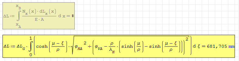

I feel useful to add some explanations concerning my developments because I recognize that it is poorly documented.
In my work I try to satisfy two antagonisms: i) That of Engineering – to affect information with units – this is magnificently served by Smath; ii) That of Mathematics, where it is preferable to avoid units, as much as possible.
An example of my practice is here:
First formula is a classic Strength of Materials one, with units inside. In the second formula, I operated some transformations, targeting to avoid units inside the integral, making it so more robust.
As for input information, I used only 3 (H;V;L) data for inextensible cable and I added 3 (w; A; E) data for the elastic cable; they are: A = area of the cable section (Surface units); w = uniform vertical load along the cable line (Force / Length); E = elasticity (Young) modulus (units Force/Surface).
Best regards,
