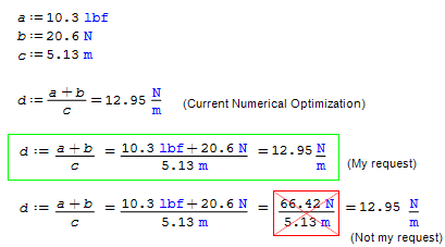

The only current way to make it work is to manually write the formula with the values and units in it, but this totally defeats the point of having a powerful program like SMath!
I can do manual calcs on paper without any programs...
All that is needed is for the display of the initial substitution, with the user defined units, before the final result is shown.
We don't need the formula evaluated with the user defined units, we only need the substitution displayed in the format of the expressed formula, that's it!
Like this:
It's totally fine if the default result is in default units, the user can manually define other units as needed.

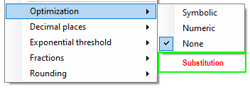

I think it makes sense to have this as an additional type of optimization, perhaps called "Substitution"?
It would be the same as numeric, since you still need the formula evaluated, but it would only display the initial substitution before the final result.

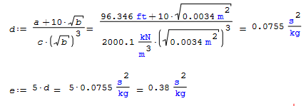

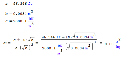

Here is an example of a nonsense equation that is a bit more complex in its formatting.
As you can see, c has only 1 decimal place, while a and b have 3. The default decimal place setting is 2.
So when the calculation of d is performed, the result is shown with only 2 decimal places, because of the default setting. I can change that if I want.
The variables are displayed in the format of the equation exactly as they are previously displayed.
Lets say that I decide to show the result of d with 4 decimal places instead of 2, and then I use it in a new equation, d will be shown with 4 as it is shown just before the equation.

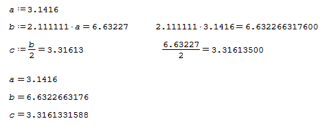

Isn't this no different than how things are now? If you define a variable out to 15 decimal places, the calculations will carry that precision through. If you define it only to 4 decimal places, then 4 is all you can get. In the end you can chose to display values differently than how SMath is using them in the calculations. Even when you get a result from an equation. That result has a level of precision that is determined by the level of precision of the variables/numbers used in the equation. You can still chose to display 2 or whatever decimals you can.
In this example, pi is defined out to 15 decimal places, I am choosing to display only 5 decimal places, but the calculation is being done with the full 15. On the side is the direct substitution calculation with the numbers as displayed. As you can see, it produces different results.
Now in this example, I have defined pi only to 4 decimal places. With trailing zeros on, you can see that the calculation is limited by the 4 decimal places I have defined.
When we mix "accuracy" we see that we get a total combined level of precision. 6+4=10.
So I'm not sure it would be any different for what I'm asking for. The calculation would still be done as before, just like any other numerically optimized calculation. Even the final result would be the same as before. You would chose how to display it, but the calculations are being done to full possible precision.
I have no idea how this would be done if you want to show step by step simplifications of equations (which is not what I'm looking for). That seems like a much bigger/harder problem to solve.
