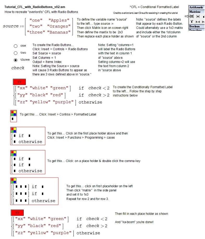

Revised: How to recreate "overlord's" CFL with Radio Buttons
Credit to overlord and Jean Giraud for guiding me along the way.
This is a revision of the previous version in this thread.
Overlord noted some valuable points after that post and it's worth looking back to his post earlier in this thread...
So, this is my attempt to include reference to those points in the revised tutorial.
The SMath file with step by step instructions.
Tutorial_CFL_with_RadioButtons_v02.sm (15.78 KiB) downloaded 1296 time(s).
Original by overlord: CFL with radiobuttons.sm
CFL with radiobuttons.sm (4.38 KiB) downloaded 1264 time(s).
Maybe these step by step, click by click instructions will help a newbie along the way.
Please let me know of any corrections.
