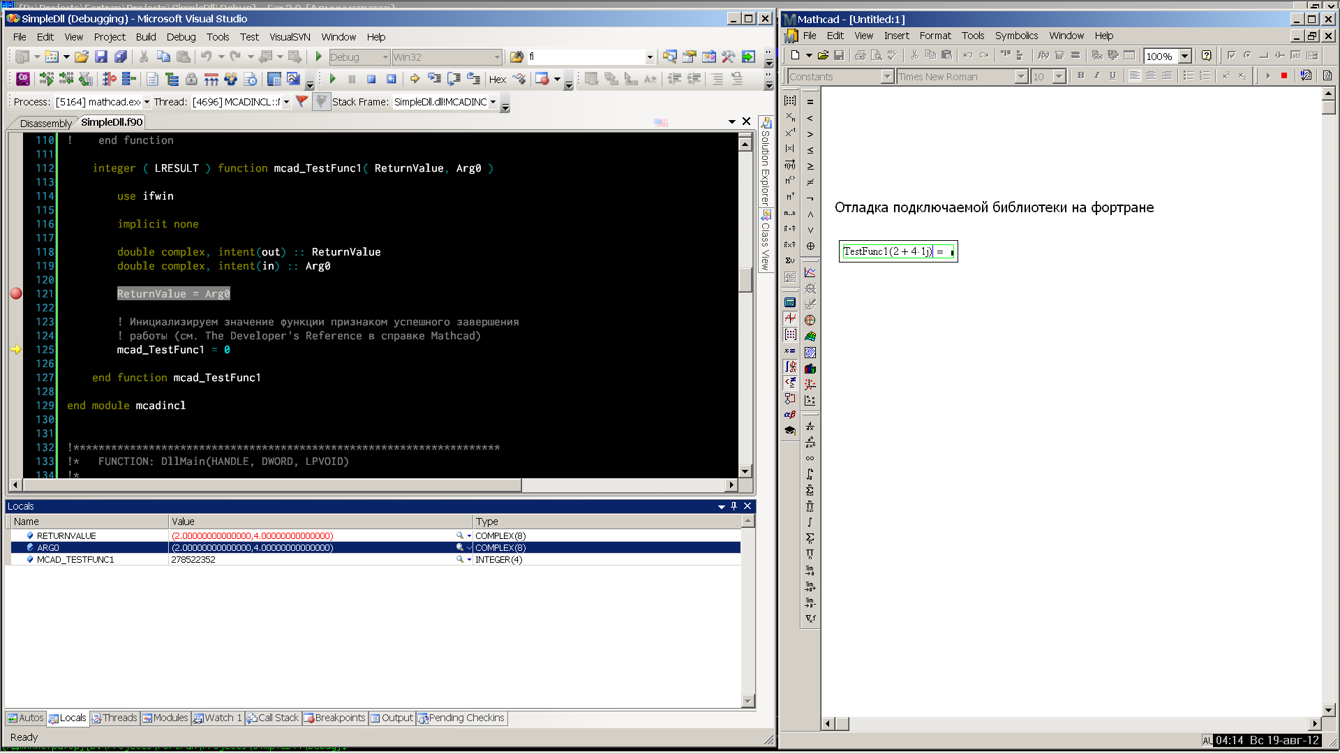

I don't like scripting languages​ because their debug is uncomfortable to me. That's how I debug Fortran program running in Mathcad. It's easy and without intermediaries.
